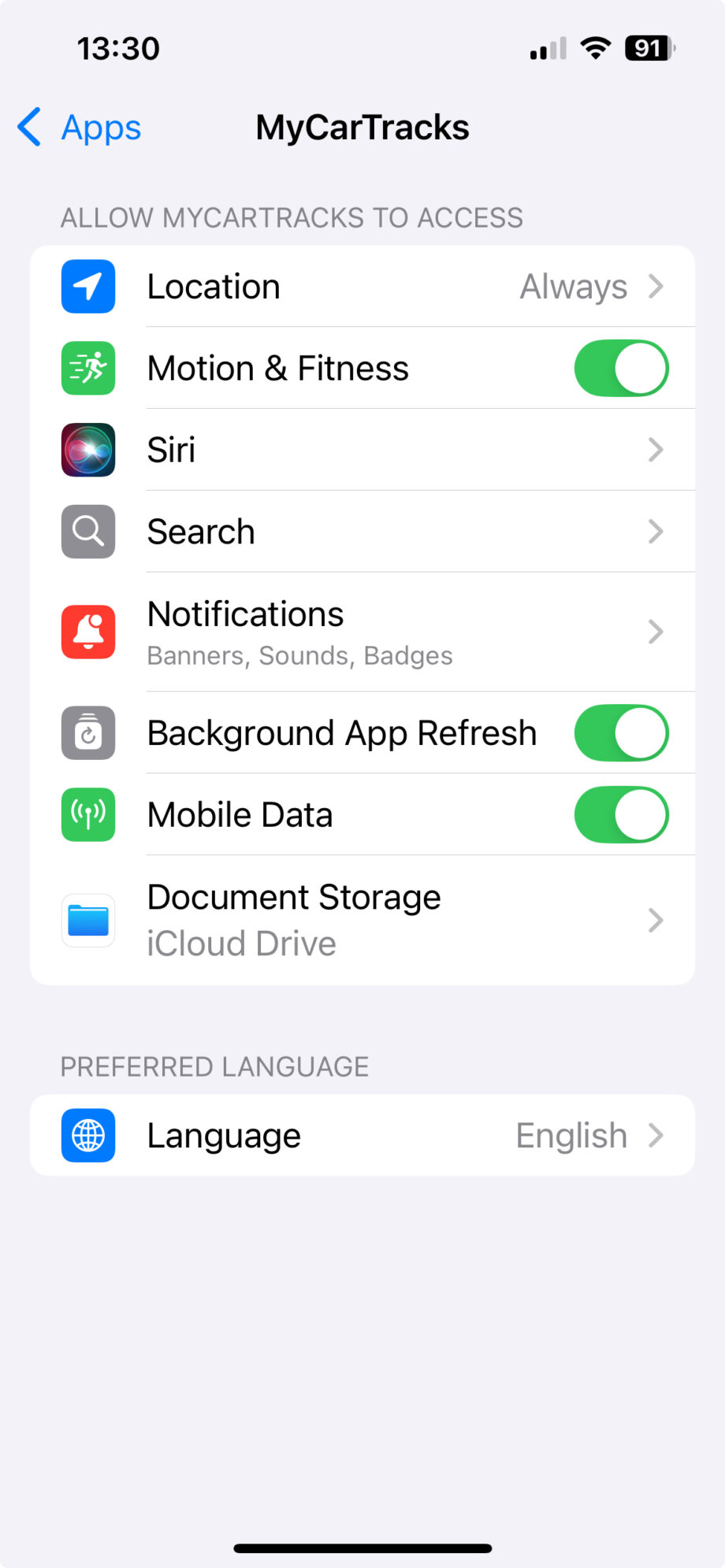

Check if all permissions that the app needs are allowed and enabled. On the phone, open the Settings app and go into Apps. Search for or scroll down to MyCarTracks and open it. Check if all permissions as shown on the screenshot are allowed.
MyCarTracks iOS Apps Settings
Make sure these are set:
  • Location is set to Always – if not touch it and change to Always.
  • Motion & Fitness is turned ON.
  • Notifications are enabled
